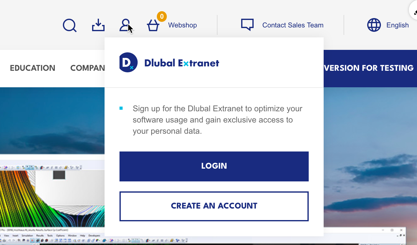

    You can find the current file in the Dlubal Extranet.
    Extranet

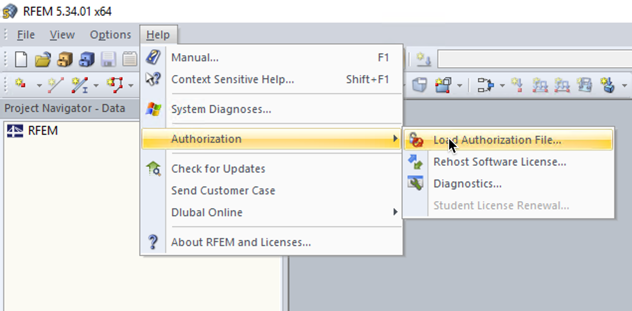

    You can import the file here:
    Load author.ini
