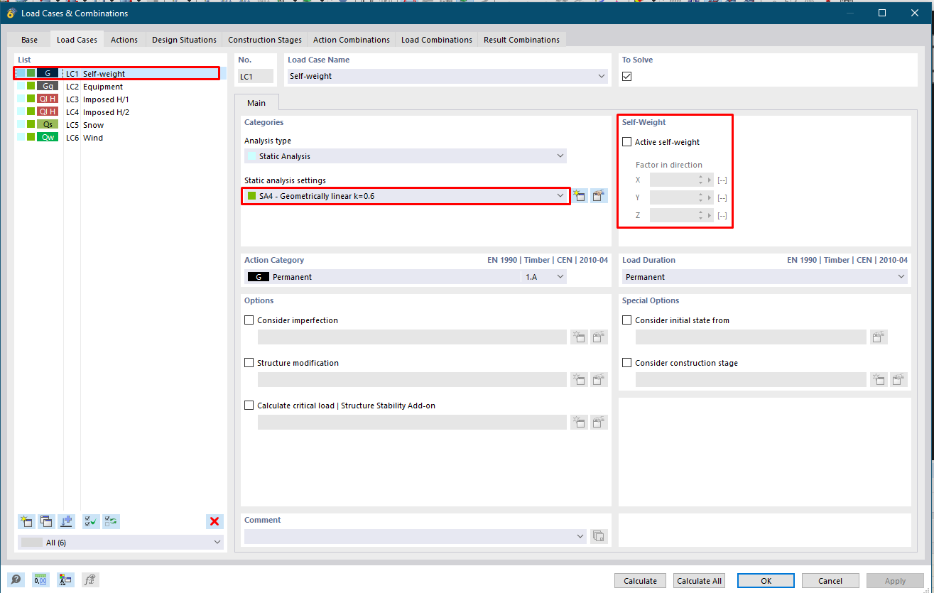

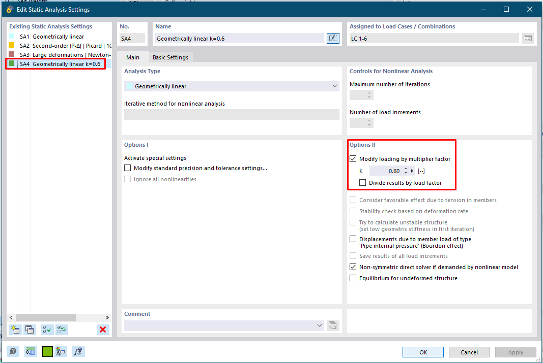

    I am facing the problem of load combination not calculating correctly due to modification of load cases with multiplier factor.

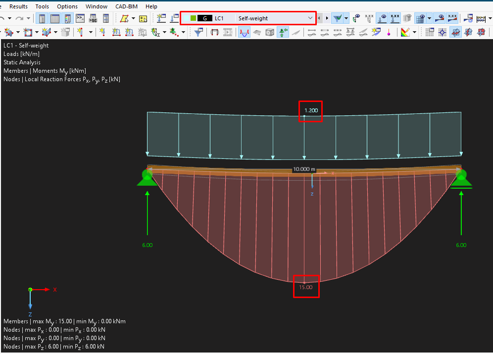

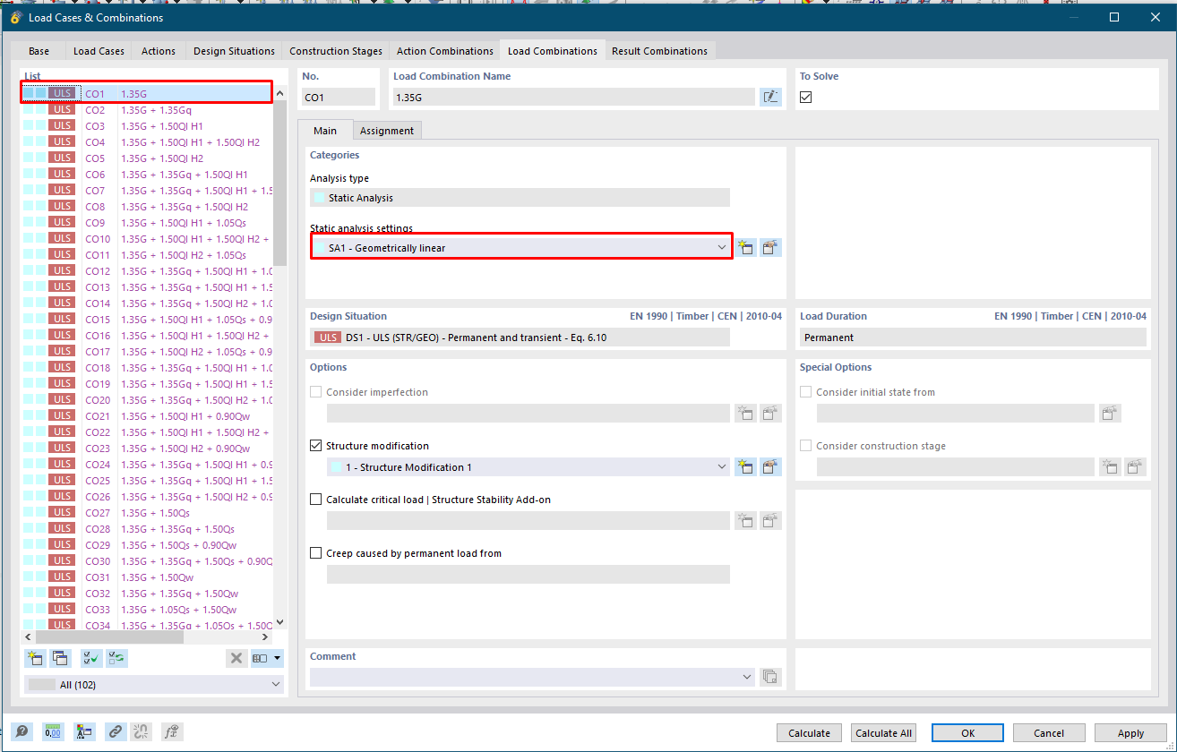

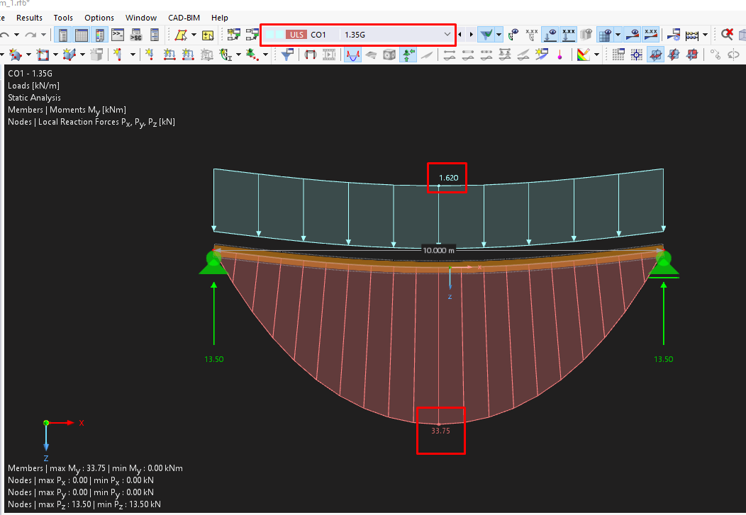

    So, when I change the "static analysis settings" for Load Cases, the loads in Load Combinations are also modified and this is normal. But the calculation results of the Load Combinations do not change. The program does not see the changes in the load combinations and does not recalculate them, which leads to inconsistent results when the loads on the screen are one and the bending moment and support reactions are different. This can be seen on the 4th screenshot (04.png). It is possible to make the program make a correct calculation if you make changes in the model. For example, move a support. Here are some pictures to prove my point.
