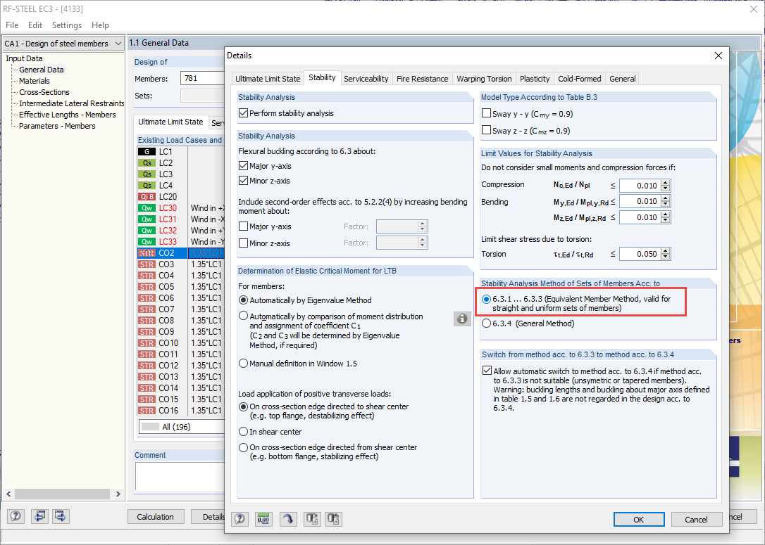

    Hello, if you define effective lengths, then the equivalent bar method is used. This corresponds to this setting in RFEM 5:
    6.3.1

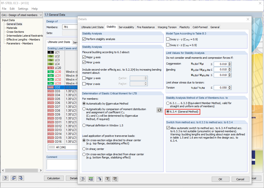

    If you define boundary conditions, the general method is used. This corresponds to this setting in RFEM 5:
    6.3.4
