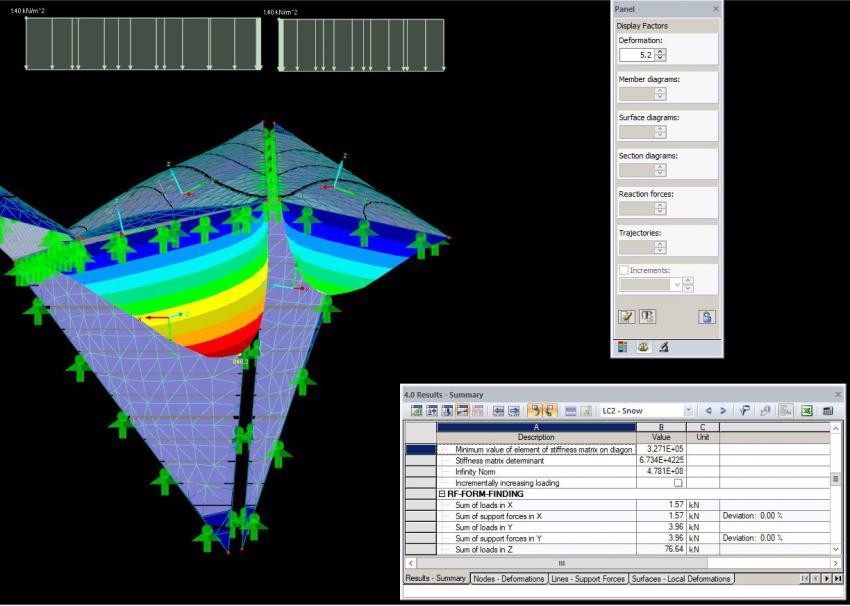

    Is there a possibility to set the scale of the resuls permanantly?
    I want it to be 1:1.

    Hello Tomasz. I'm sorry, there's just no way. The factors are always determined dynamically by program.
