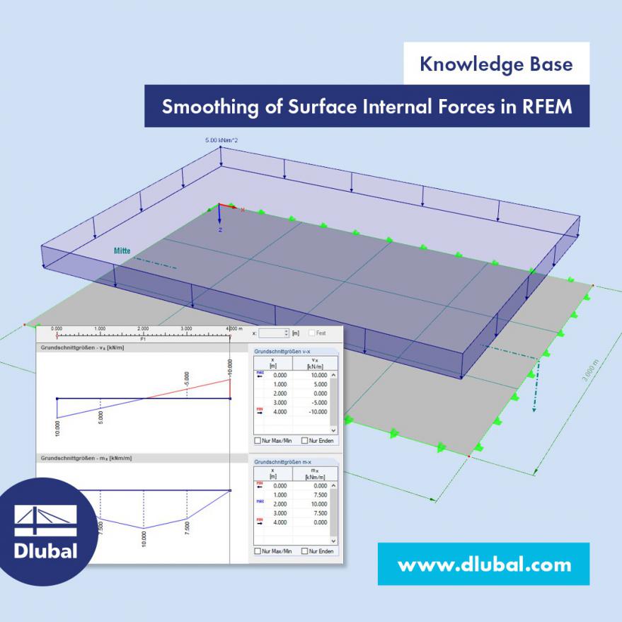

When calculating a surface model, the internal forces are determined separately for each finite element. Since the element-by-element results usually represent a discontinuous distribution, RFEM performs a so-called smoothing of the internal forces that takes into account the influence of adjacent elements. With this method, the discontinuous distribution of internal forces is adjusted. The results evaluation is thus clearer and easier.
Smoothing of Surface Internal Forces in RFEM
When calculating a surface model, the internal forces are determined separately for each finite element. Since the element-by-element results usually represent a discontinuous distribution, RFEM performs a so-called smoothing of the internal forces that takes into account the influence of adjacent elements. With this method, the discontinuous distribution of internal forces is adjusted. The results evaluation is thus clearer and easier.Stichworte: -
