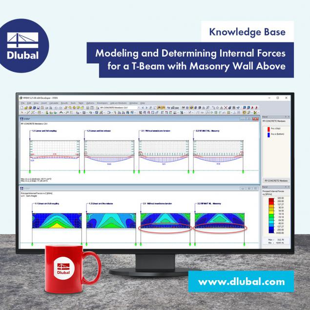

Modeling and Determining Internal Forces for a T-Beam...
When modeling a rib of reinforced concrete with a masonry wall above it, there is a risk of the rib being undercut if the structural behavior of the masonry is not correctly considered and the connection between masonry wall and downstand beam is not modeled with sufficient accuracy.
When modeling a reinforced concrete rib with a masonry wall above, there is the risk that the rib is underdesigned if the structural behavior of the masonry is not correctly considered and the connection between masonry wall and downstand beam is not modeled sufficiently accurate.
