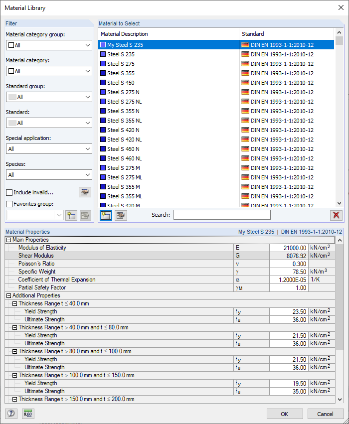

        Hello. This is how it works: Create a new material and open the material library.

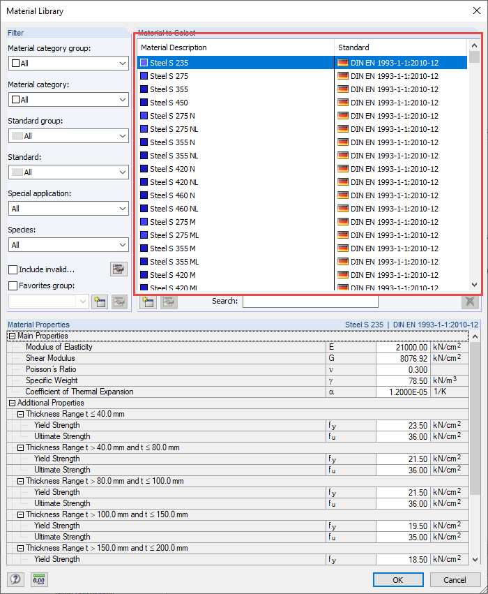

        In the library, find a material that is as similar as possible to the new material. Click on it once in the list.
        find a similar material

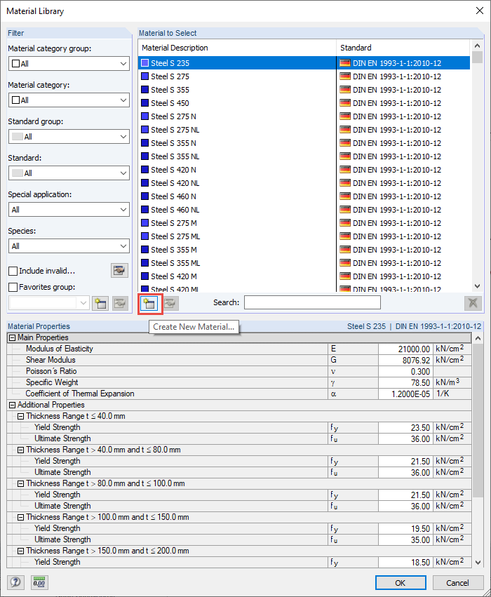

        Click on "Create New Material...".
        Create New Material

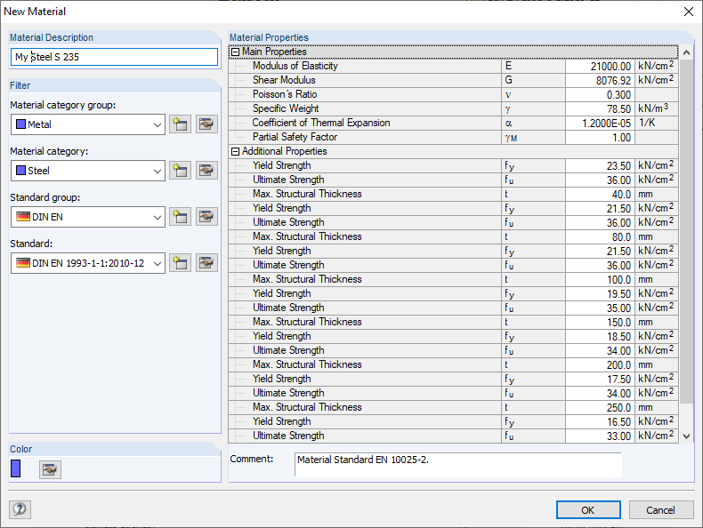

        Define a new name and enter the parameters and confirm the dialog.
        New name
        The new material is now in the library and can also be used in the new RFEM file.
        New material

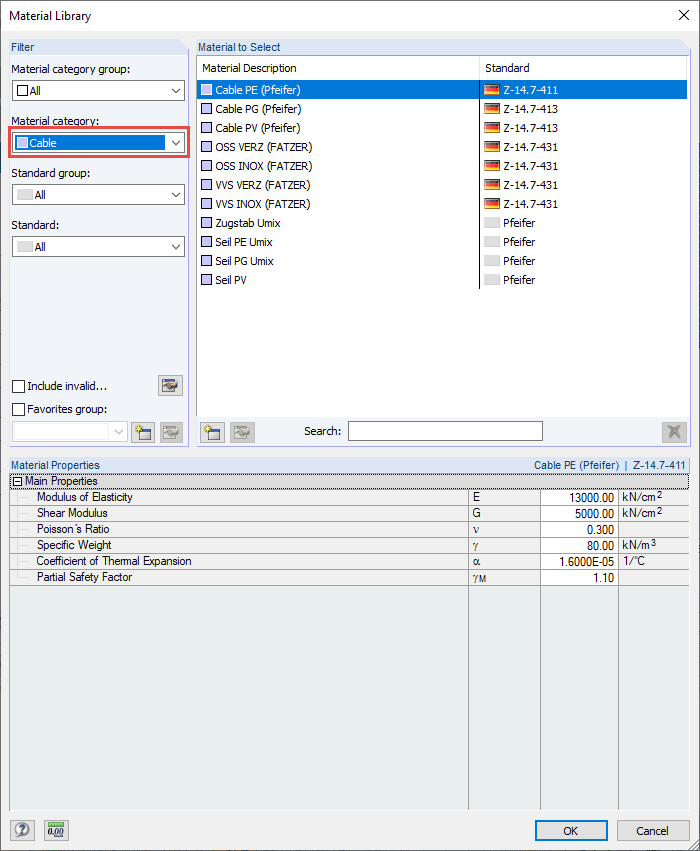

                Hello Tomasz, there are no membrane materials in our database. But what we have are cables:
                Cables
                Please note: Cables have a special non-linearity, the stretching. This is not taken into account in the RFEM calculation.

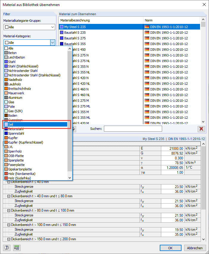

                    i am trying to find the "cable" but i think there is no such thing in the german version, isn't it?!
                    thanks
                    • #11
                      Hello. This is also available in the German version. There it is called "Seil".
                      Material Seil
