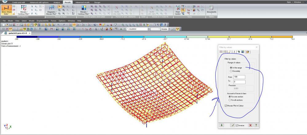

    Dear colleagues, is any possibility in dlubal RFEM, to select results (internal forces, displacements or etc) by range, like s Lira?Klicke auf die Grafik für eine vergrößerte Ansicht

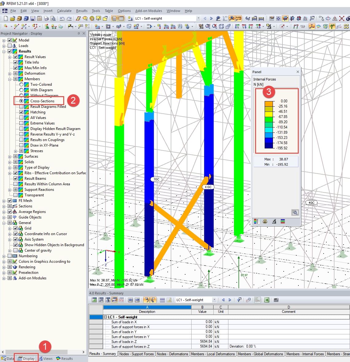

    Hello Giorgi, there is a similar function in RFEM.
    1. To do this, switch on the Display navigator.
    2. Switch to the display of the internal forces on the cross-section.
    3. Edit the color scale by double-clicking it and select the required range.
    Frank
